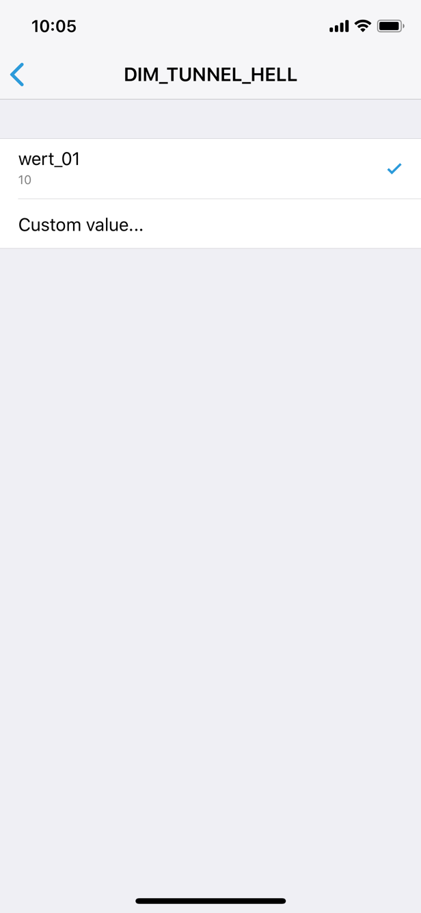

While playing with the demo version of Bimmercode I found this code that can be modified. Anyone able to try this code and report back?
This is under instrument cluster, 3007 KI_DIMMUNG. Tons of other dimming options there but I've never done coding before and have no knowledge on this

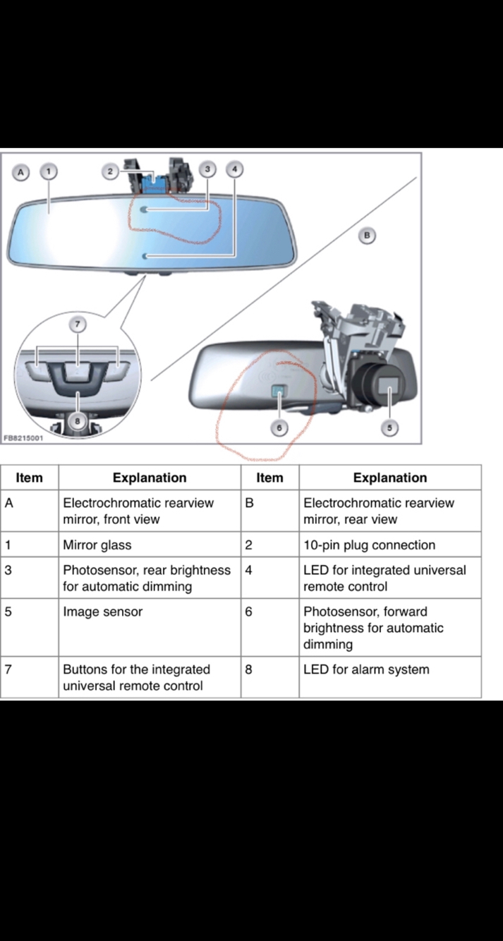

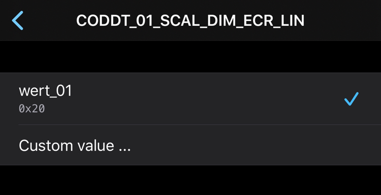

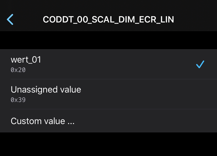

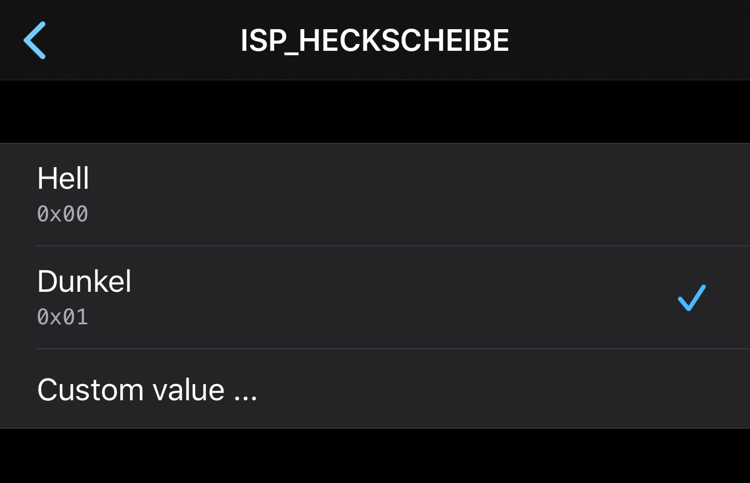

Anyways, he can try to code a lower the light sensitivity of the auto dimming mirrors, which can have a direct effect on the overall dimming of the instrument cluster.
FEM>
CODDT_[COLOR="DarkRed"]00[/COLOR]_SCAL_DIM_ECR_LIN (left mirror): Under "Custom Value" the range is from "20" being the least dimmed and "39" being the darkest.
and CODDT_[COLOR="DarkRed"]01[/COLOR]_SCAL_DIM_ECR_LIN (right mirror):
Under "Custom Value" the range from "20" being the least dimmed and "39" being the darkest.
ISP_HECKSCHEIBE (Rear View Mirror): "Hell" is bright and "Dunkel" is dark.
Or, he can just go old school and put a piece of black tape over the light sensor(s), which is located on the HVAC controls, front and rear of the Rearview Mirror.

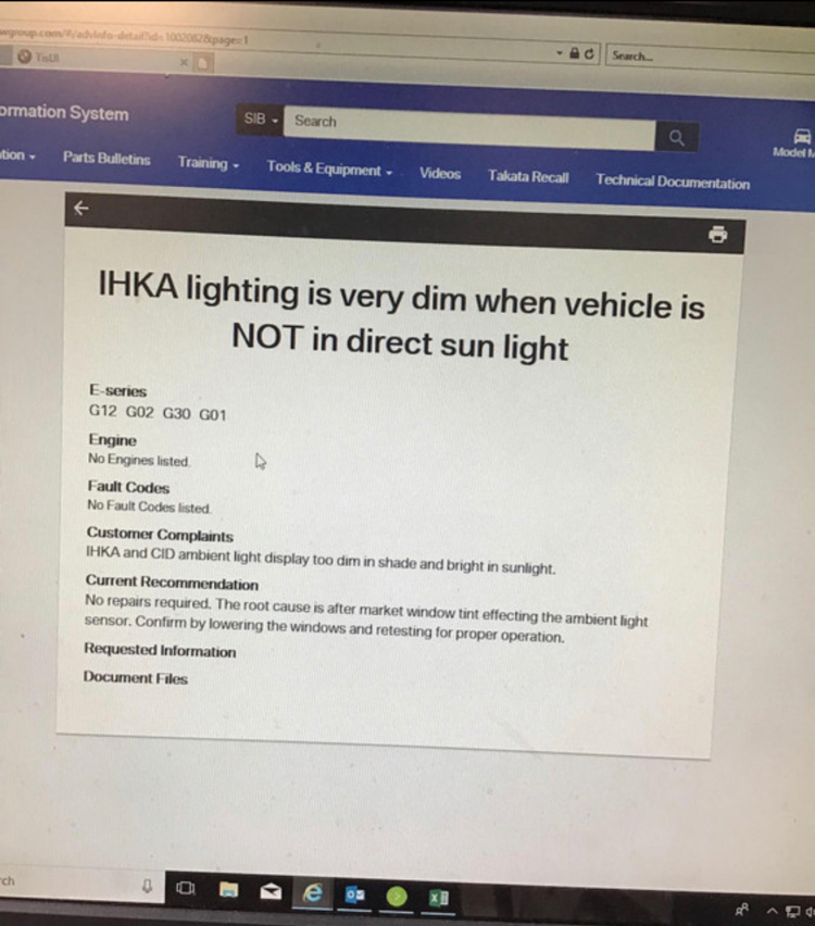

No problem and I hope it works out for you because according to BMW NA, there is no 'official' fix for this issue, in vehicles with aftermarket tints.
However, the coding parameters I supplied above is what BMW adjusts, when "S420A - Sun Protection Glass " (rear factory tints) is optioned on the M2 (Outside of North America).
Also, below is an illustration of where the interior light sensor are located in the cabin, incase you want to try my ghetto suggestion to trick the sensors.
