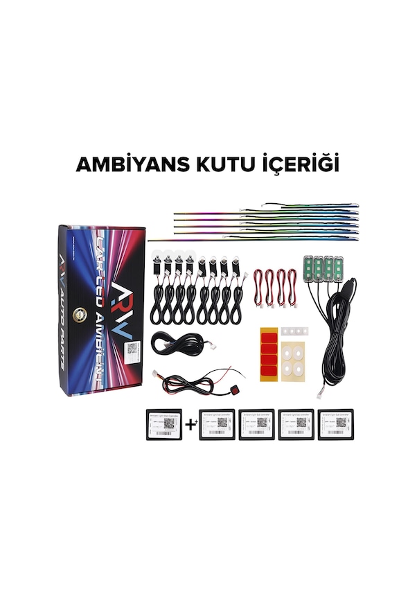

Hello everyone,
I am joining you from Turkey.
My vehicle is 2007 Model LCI m47 163'lı 5.20d
I want to explain the issue to you as follows;
I bought the 64 color 120 mode ambient lighting attached to my vehicle.
I did not reconnect the doors because this product consists of 4 auxiliary brains and 1 main brain.
I got the electricity from its own ambient lighting for the installation on the doors.
I used both the main brain for the front fascia and got the electricity from the cigarette lighter. I did not get it from the parking key.
Now what I really want to ask is this:
Everything works fine.
Since I got the electricity for the front fascia from the cigarette lighter, it works without any problems, but
the ambient lights on the doors turn off in 10-15 seconds when I turn on the park lights.
When I turn off the vehicle, start it again and turn on the park lights, the same problem occurs again.
I think it cuts off the electricity. To try this, I cut the power to the main brain for a while and turned the parking light back on. Then it worked.
When these auxiliary brains are activated, the vehicle cuts the power.
What is the solution? The ambiance suits these vehicles very well.
Can you please help?

Sounds like you connected the brain box to the welcome light for power on the doors. Try to connect it to one of the original upper ambient in the door panel see if that fixes the problem.
