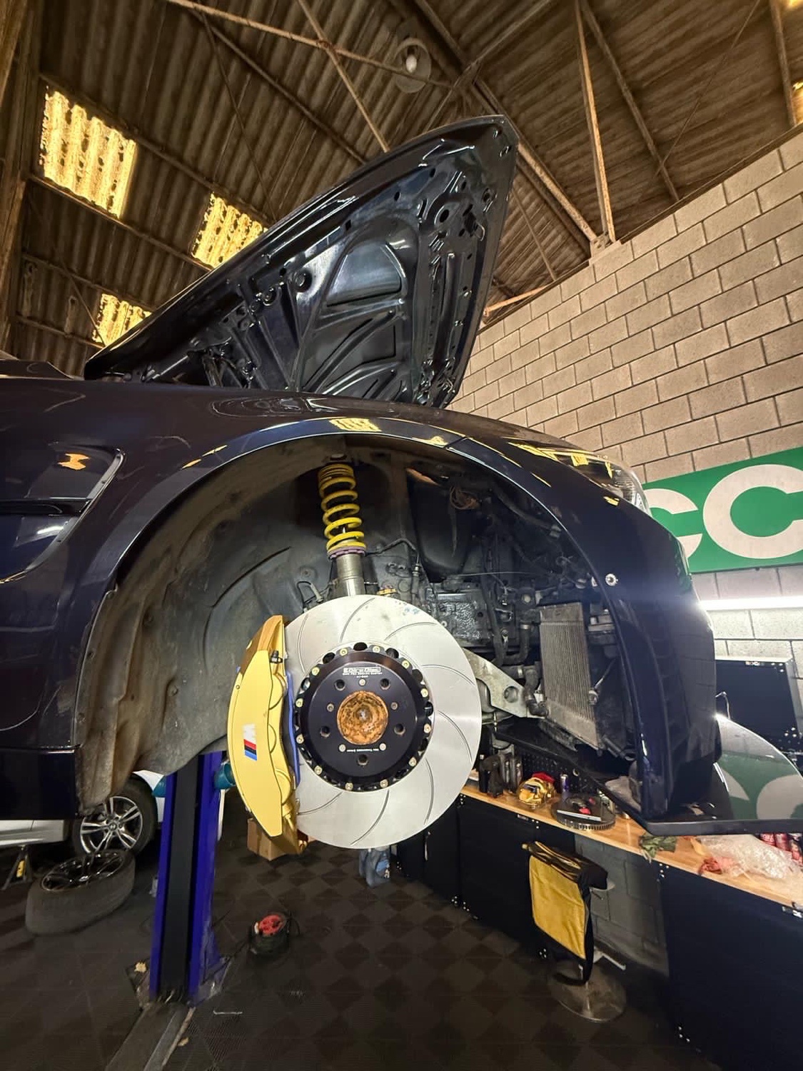

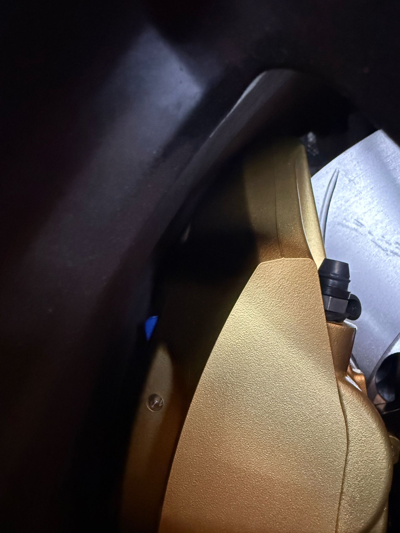

Mounted and gonna test it at home with 18 inch if all fit will share the drop of the wheel.

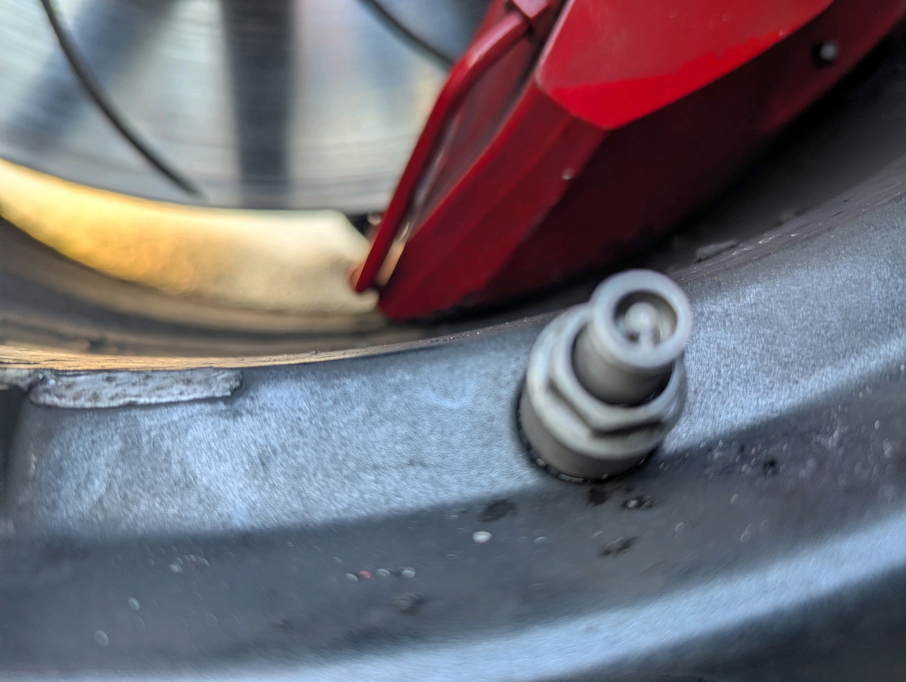

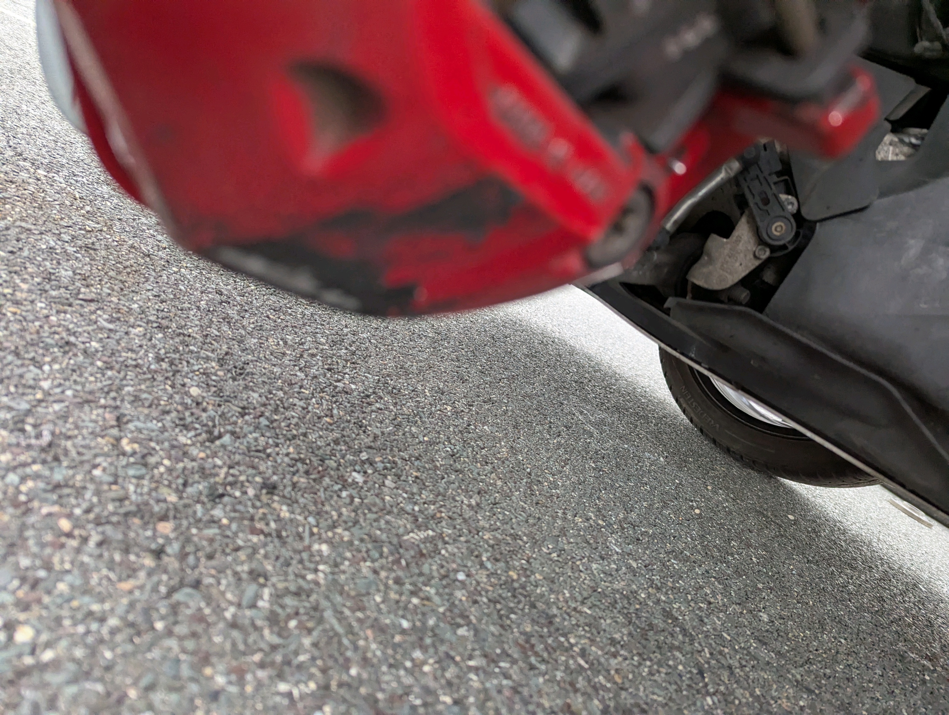

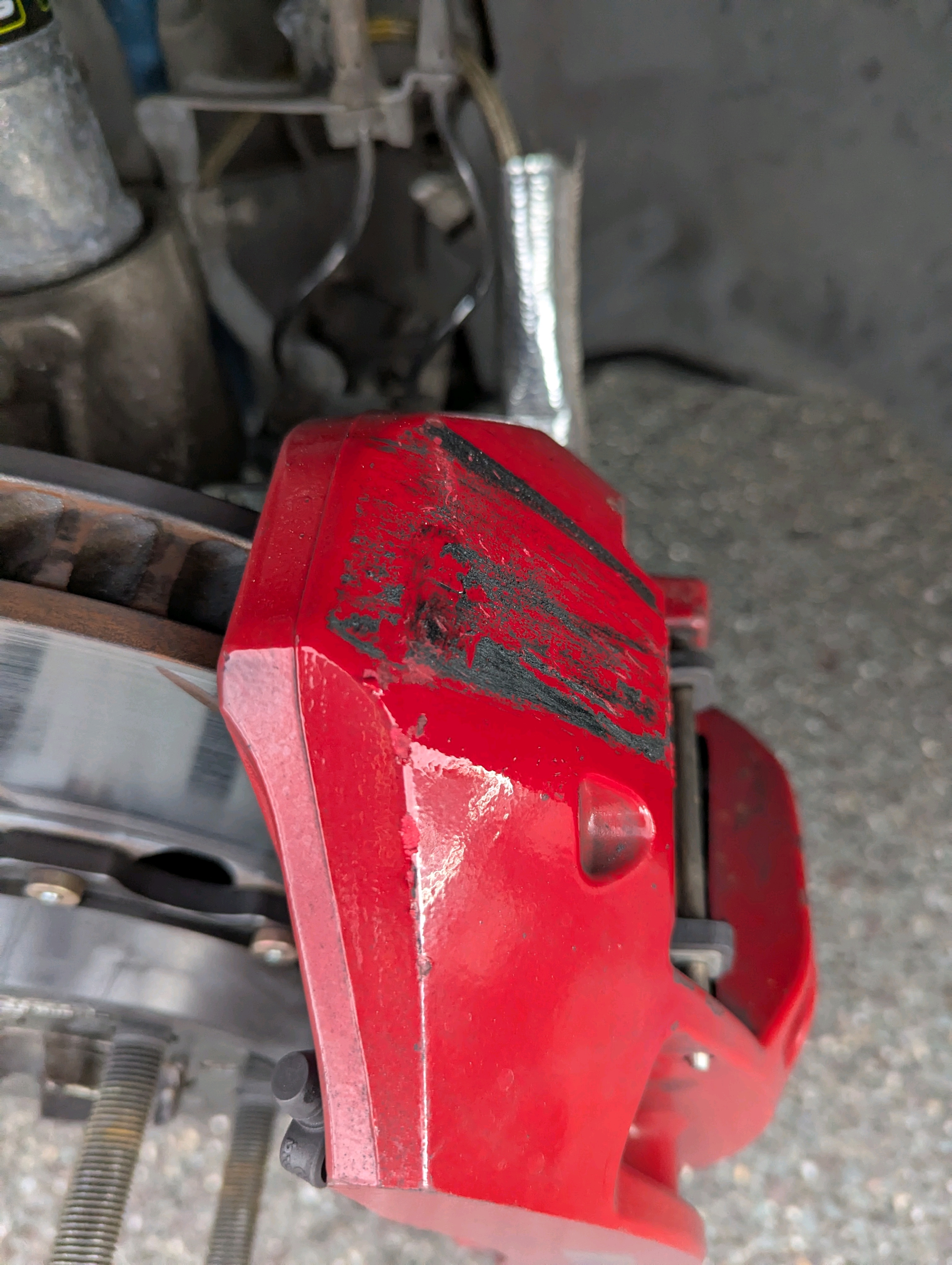

So they don’t fit Protrack One 10.5J ET27 with 12mm spacer.
Need more space so will probably shave it like 2-3mm to pass it like Track/S suggest me because i don’t have any other wheel and have a trackday soon 😅

With protrack need to shave the caliper a bit.

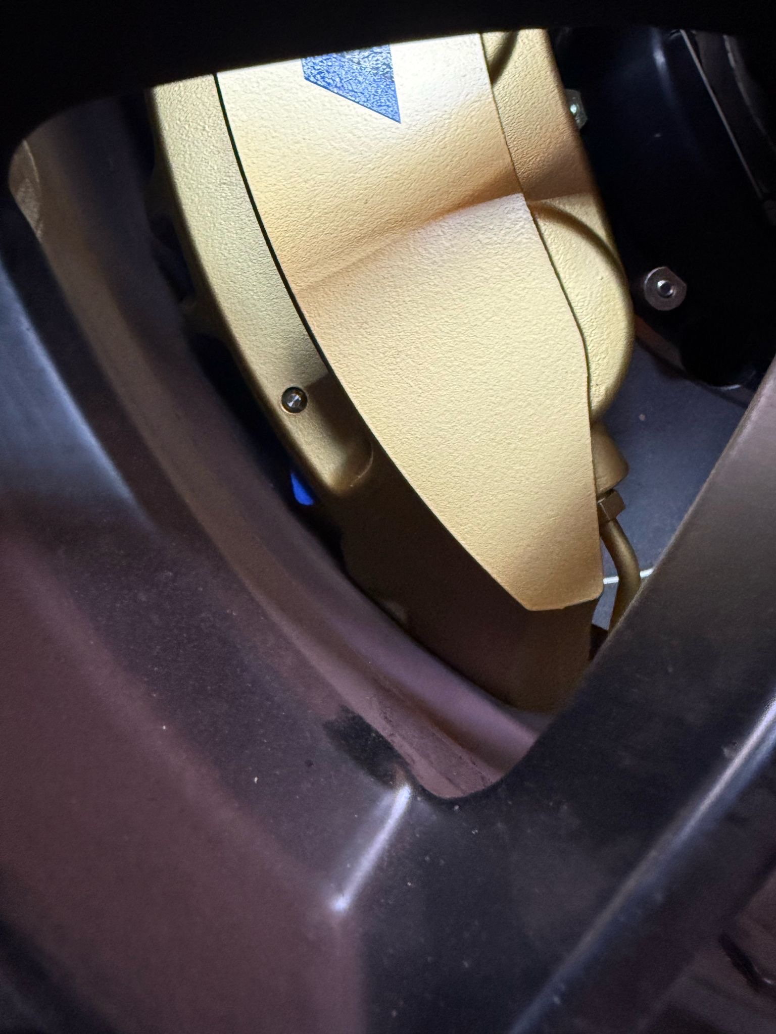

I can confirm caliper clearance with Apex VS-5RS wheels 10.5x18 ET40. (20 mm spacer used to clear spring pearch).

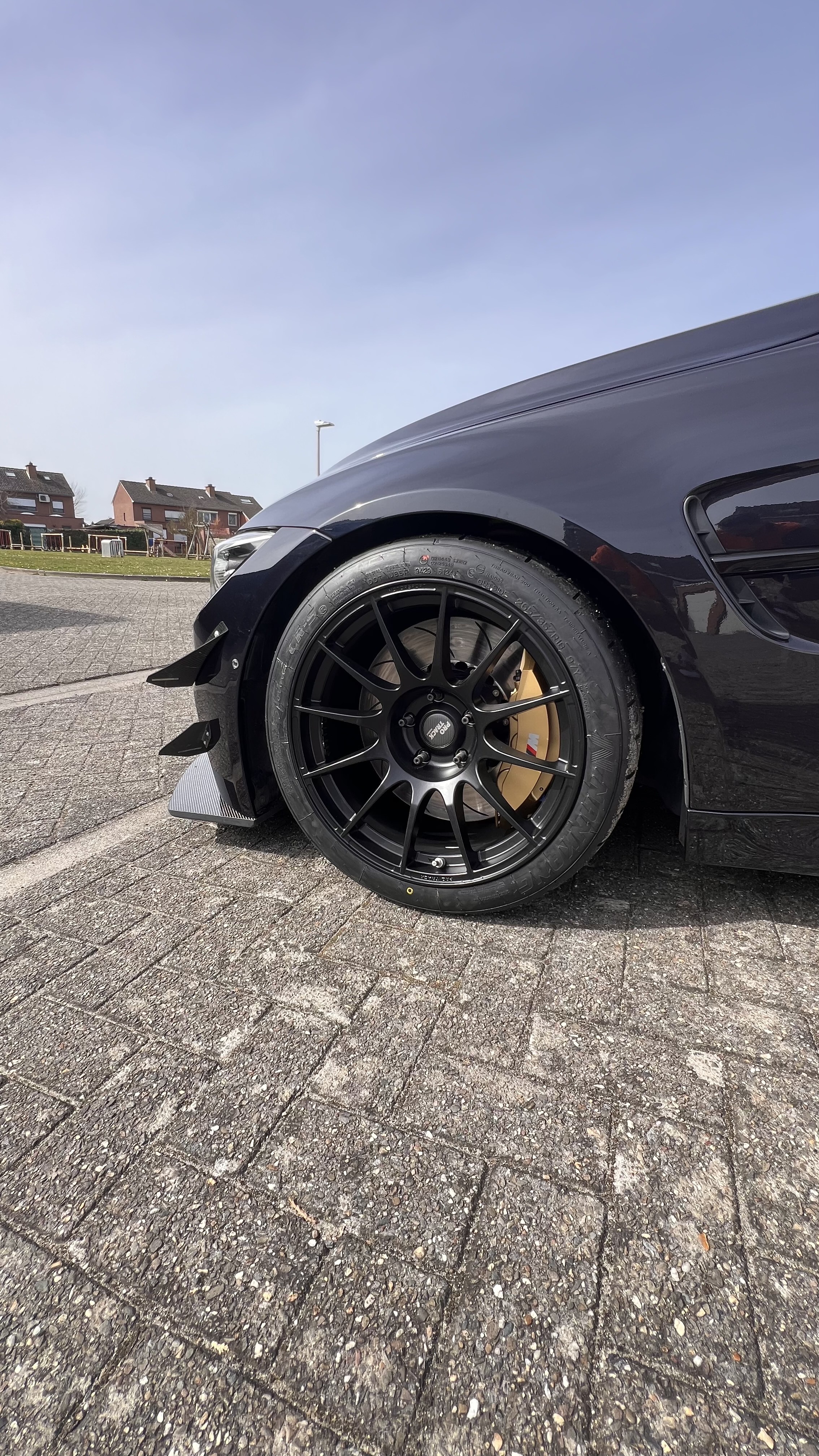

After i shave the caliper and test it on track no issue at all.
By the way for those who come from blue caliper i suggest to code DSC, the brake pedal feeling are much better !
